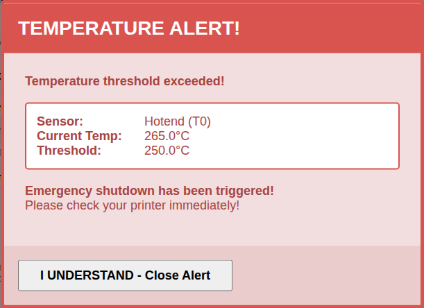

  • Immediate Alert System: Displays a prominent alert popup in the OctoPrint interface when thresholds are exceeded

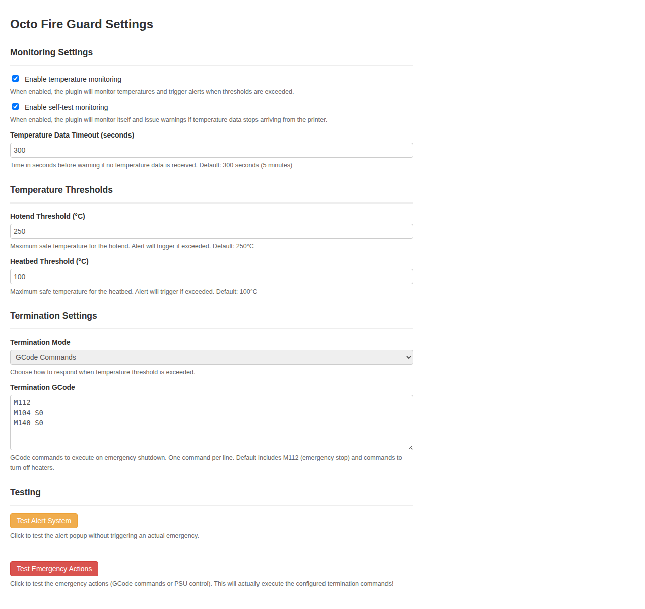

After installation, configure the plugin in OctoPrint Settings → Plugins → Octo Fire Guard:
settings screenshot
Temperature Thresholds
  • Hotend Threshold: Maximum safe temperature for the hotend in °C (default: 250°C)
  • Heatbed Threshold: Maximum safe temperature for the heatbed in °C (default: 100°C)
Self-Test Monitoring
  • Enable Self-Test Monitoring: When enabled, the plugin monitors itself to ensure it’s receiving temperature data from the printer
  • Temperature Data Timeout: Time in seconds before issuing a warning if no temperature data is received (default: 300 seconds / 5 minutes)
If the printer is connected but the plugin doesn’t receive temperature data for the configured timeout period, it will issue a warning notification. This helps ensure the plugin is functioning correctly and actively monitoring your printer.
Termination Mode
Choose how the plugin responds when a threshold is exceeded:
GCode Commands Mode
Execute custom GCode commands to handle the emergency. Default commands:
M112        # Emergency stop
M104 S0     # Turn off hotend
M140 S0     # Turn off heatbed
You can customize these commands to suit your printer’s requirements.
PSU Control Mode
Integrates with the PSU Control plugin to turn off power completely. This mode:
  1. Turns off heaters using GCode
  2. Signals the PSU Control plugin to cut power
Note: Requires the PSU Control plugin to be installed and configured.
Testing
The plugin provides two test buttons in the settings panel to verify functionality:
  • Test Alert System: Tests the alert popup display without triggering emergency actions. This verifies that the visual alert, audio notification, and user interface components work correctly.
alert screenshot
  • Test Emergency Actions: Tests the actual emergency response by executing your configured termination commands (GCode or PSU control). Use this to verify that your emergency shutdown procedure works correctly before an actual emergency occurs.
Important: The “Test Emergency Actions” button will execute the real emergency shutdown commands configured in your termination settings. Make sure your printer is in a safe state before testing.
