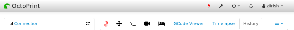

overview

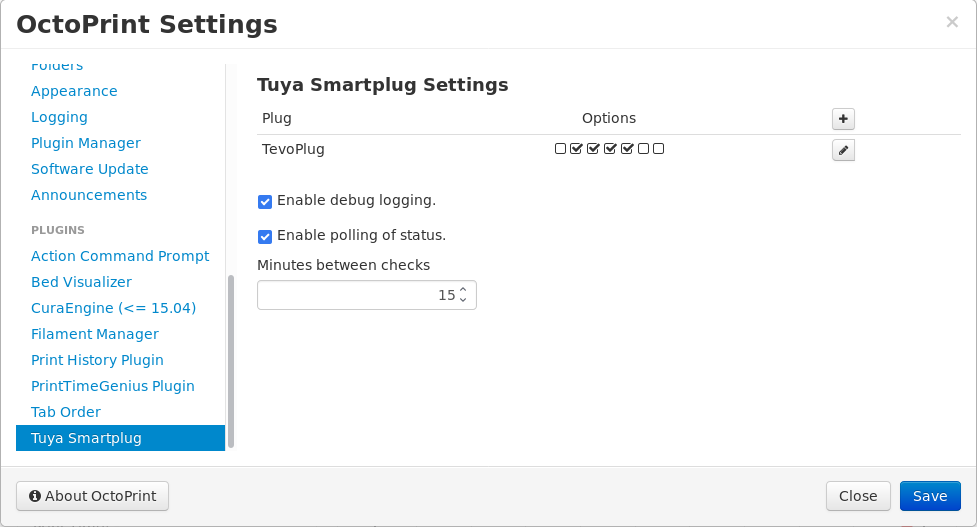

Settings
settings

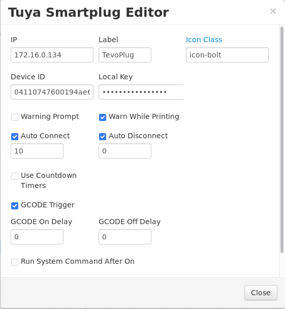

Once installed go into settings and enter the ip address for your Tuya Smartplug device. Adjust additional settings as needed.
screenshot
  • IP
    • IP or hostname of plug to control.
  • Label
    • Label to use for title attribute on hover over button in navbar.
  • Icon Class
    • Class name from fontawesome to use for icon on button.
  • Device ID
    • Plug ID.
  • Local Key
    • Local key to cypher data.
  • Warn
    • The left checkbox will always warn when checked.
    • The right checkbox will only warn when printer is printing.
  • GCODE
    • When checked this will enable the processing of M80 and M81 commands from gcode to power on/off plug. Syntax for gcode command is M80/M81 followed by hostname/ip. For example if your plug is 192.168.1.2 your gcode command would be M80 192.168.1.2
  • postConnect
    • Automatically connect to printer after plug is powered on.
    • Will wait for number of seconds configured in Auto Connect Delay setting prior to attempting connection to printer.
  • preDisconnect
    • Automatically disconnect printer prior to powering off the plug.
    • Will wait for number of seconds configured in Auto Disconnect Delay prior to powering off the plug.
  • Cmd On
    • When checked will run system command configured in System Command On setting after a delay in seconds configured in System Command On Delay.
  • Cmd Off
    • When checked will run system command configured in System Command Off setting after a delay in seconds configured in System Command Off Delay.
